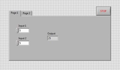

I'm using Tab control (multiple) and there are some controls over there. What I'm trying to do is:
The same control will be available in the different tab and if in one place control value changes another tab's control value will be updated with the same value.
For easy demonstration I'm giving an example:
Here, Firstly Input 1 should be available in the page 2 tab, and then if I change the Input 1 value from page 2, page 1 Input 1 value will also change. So Input 1 control value should be the same on page 1 and page 2 tab.
Snipped also attached if you need to change in this example.
Appreciate your kind help.

Hi Reduanul,
When the control should be visible on all tabs then you need to place that control over the tab container, but not inside the tab container!
  1. Move the control outside the tab using the mouse.
  2. Then select the control and move it using the arrow keys over the tab container! (Maybe change the z order using the foreground/background/grouping options in the menu to get to control in front of the tab container!
  3. Now you are done: the control will be visible on all tabs… (The border visible at edit time will vanish at runtime.)

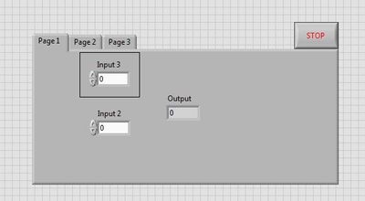

Thanks, GerdW it's working 🙂
Now is it possible to get rid of the black border color at edit time?
Then can I make control visibility on selective tabs instead of all? (e.g only on tabs 1 and 2 whereas I've 3 tabs and on tab 3 it will not be visible)
Like this:
Last time as I said I uploaded a snippet that will work if you drag that image to the block diagram. I've checked it worked 🙂
However, this one is the updated snippet for the above case.
- Reduanul
Message 3 of 8
(3,147 Views)

Hello GerdW,
@GerdW wrote:
The black border will always be visible at edit time.
It will be also possible to remove the black border invisible at edit time (I tried and it works). For this you just need to put the control on a flat box like this:
Thanks for your awesome help 🙂
