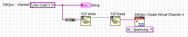

Hi Keith,
you can handle the channels like "normal" strings. See the attached picture.
Hope it helps. Mike

AHA!  I hadn't realized you could implicitly convert between a channel and a string.  That's exactly what I needed.  Thanks!
