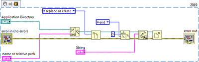

Hello GerdW,
Here are my subVI snipped.
First, I have created a file. After one execution file is being replaced, each time string values are saved but with existing data. Probably here, I need to make some changes (if I didn't get you wrong). But not getting what will be the changes!

Hello crossrulz,
Yes, I did it.
Here what I did:
Everything works for the initial saving operation, but when the second time (and later on) I am saving, data is adding with exiting string values.

You are placing the file pointer to the end of the file therefore you are simply appending the data. Don't set the file position and see if you get your desired results.

Hello Mark Yedinak,
I tried it but not working. Same thing happening (appending with existing file) 😞

If you are replacing or creating a file, there is no reason to set the file pointer to the end.
