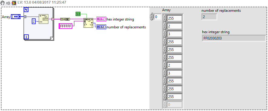

How can I delete a specific pattern from an array
I have a question on what is the fastest- less memory way to remove a specific pattern in a 1D array
For example in 1D U8 Array I would like to delete ( and count the number) whenever I have 3 consecutive  0xFF
For instance :   0xFF 0x2 0x3 0xFF 0xFF 0xFF 0x2 0x3 0xFF 0xFF 0xFF  becomes 0xFF 0x2 0x3 0x2 0x3   and I had this pattern 2 times in my array
Many thanks

If you're considering only U8 arrays, I'd suggest the Search and Replace String option.
This link might also be useful: How to Convert Between Hexadecimal and ASCII in LabVIEW?

Question:  What happens if there are 4 or more in a row.
I'd just program it in a loop.  Search 1-D array for FF.  See if the next two elements are also FF.  If so, delete from array.  Search 1-D array from that point on for next FF.  Stop when you get to the end of the array.

You will probably have to benchmark it but array operations may be faster that converting back and forth to strings.
Let's make this a bit simpler:
And I'm quite sure this is much more efficient than Bens solution (Byte Array to String and String to Byte Array are basically no-op functions).
(4,549 Views)
Agree with you, about 4X faster.
