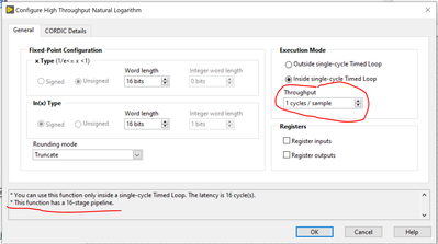

I noticed that on the configuration page of the function it say that the function is not pipelined.
So I don't think my guess is correct.
Message 3 of 14
(4,916 Views)
Well, it still is delayed, although they seem to not call that pipelined. You see the Throughput control that specifies 16 cycles per sample. This means you have to iterate 16 times before the correct result appears at the output. And yes you need to use the handshake controls too.

The function is pipelined if we reduce the throughput.
My question here is how is it being implemented without pipeline since CORDIC is iterative?
Also in order to pipeline the function it would require the use of loops with shift registers or feedback nodes. Using feedback nodes makes the code highly complex. And using loops would not support the function in SCTL. So how is this function implementing CORDIC?

Well, as you can see the function has either a 16 cycle latency or a 16 cycle pipeline (or a combination of both).
Basically the logic is so called unrolled and in each cycle the data goes through the next stage. The CORDIC algorithm while iterative seems to be able to be completed in 16 or less iterations so instead of putting a loop in a loop, you let the outer loop do the looping for you. If you decrease the latency, the algorithme uses extra pipelining which requires more resources as for each pipeline stage the entire logic has to be fully present. Without pipelining the logic can be reused in each iteration as far as possible but the latency is higher and you need the outer loop to be up to 16 times as fast as the sampling frequency of your signal.
The delay from when your data arrives at the input until it appears at the output is in all cases always 16 iterations.
If you want to know more details about the actual implementation you will have to ask Xilinx. Much of the core of the high throughput functions is not designed by NI themselves but they use premade IP modules from Xilinx for that.
This is a very simply idea how you can do this for a 16 latency algorithme.
