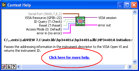

How Do I Use the Help Tag/Help Path in LabVIEW to Link to a Specific tag in an HTML File?
Is there any way to point user to a tag in an HTML file when he click "Click here for more help" ?

Yes you can. In VI properties --> documentation you can browse for your help file.

It's easy to point to an HTML file.  What I want is point to a tag inside an HTML file.  For example: MyVI.htm#tag123

I believe you are correct in saying that there is no way to link directly to a specific anchor tag within an html file from the context help.
I would encourage you to visit our Product Suggestion Center if this is a feature you would like to recommend that our R&D team consider for future versions of LabVIEW.
Is it possible for you to create a .chm file?  Or perhaps you could have some kind of "table of contents" at the top of your .html help file.  This would require an extra click by the user but may be an option for you.
