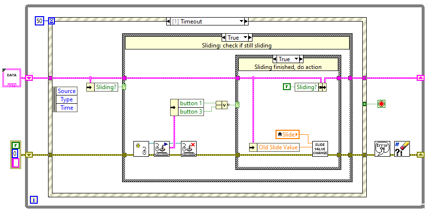

This is indeed difficult because Slides are normally designed to trigger events while it updates, and there is no "Update Value while Sliding" option that can be unckecked, similar to "Update Value while Typing" option for Strings, sadly...
Moreover, there is no convenient "Mouse Up" event that fires even when the user released the mouse button outside the VI window.
So here is how I would do:
1. On value change, set a flag to true and retain the "Old Value". Use the flag to only do that on the first value change event, not on subsequent ones:
2. On Timeout (here I set a resolution of 50ms), check that the sliding is still occurring. If it is not (left/middle buttons are released), trigger your custom action. Finally reset your flag:raphschru_1-1735506909376.png
Raphaël.

Thanks!  That does seem to work.  I have done a lot of similar things but this seems to be more robust.
Whats strange is this was not a problem way back in LabView 7.1 or thereabouts. It just worked.  At some point it stopped and its been a pain ever since.  Thank you so much!

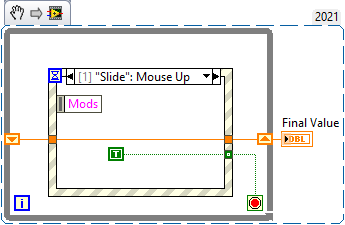

Well, here is another way that seems to do exactly what you want.  There are two events you need to "capture".  One is when the Slide value changes -- well, that's simple, you have a Slide Value-Change Event, and save the Slide Value in a Shift Register on the surrounding While Loop (being sure to carry the value through the other Cases).
The "other Case", of course, is a Slide "Mouse Up" Event, which you want to mean "I'm done manipulating the Slide, now I want its most recent value".  You do this by simply stopping the Event Loop by wiring "True" to the Stop indicator of the surrounding While Loop, and taking the output from the Shift Register (which is the last changed value of the Slider).
Here is a Snippet, showing the Mouse Up case.  The other case is the Slider Value Change case that sets the "changed" Slider Value into the Shift Register.
For this to work, you must manipulate the Slider (which you do by clicking on it with your mouse, a Mouse Down Event, and unless you want to keep your finger on the slider all day, you must also (eventually) do a Mouse Up, setting the Slider value.
Hmm -- there may be a bug, but I can envision a fix.  It's late, and my eyes are getting bleary, so I can't test it now.  But what happens if the slider is not at 0, you click, but don't move the slider before letting go.  Do you get the loop to stop, and does it have the right "Mouse-down" value?

The problem with that is if the user moves the mouse pointer off the slider before releasing the mouse, there will be no "Mouse Up" event on the slider.

Not if the user releases the mouse out of the VI window, which is why I opted for the Timeout / "Input Device Control" VIs solution.
