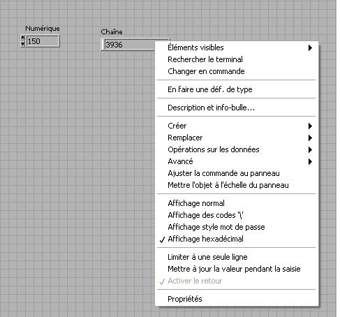

My problem is : I have to convert a decimal number to hexadecimal to send it. So, I use the fonction "convert number to hexadecimal string". I connected the output with an indicator.
But it doesn't work for my case because when I choose (with left click) hexadecimal display I don't have the "good" thing. For "normal display", the hexadecimal number is good.
An exemple : Decimal 200, convert to hexadecimal in normal display : 8C & in hexadecimal display : 3843.
Actually my instrument receive "3843" and it don't work.

Hi Hreidmarr,
I think I understand what you are saying.
Do you need to change the string control to the Hex display? The hex display is showing the ASCII representation of the hex string. If you leave it in normal display you will get the hex value you expect.
i.e. 200 = C8
Olly

For more details, screenshot and my code
I think my device doesn't work because it read the normal value but it need the hexadecimal value

I don't think that's why your device (whatever it is) doesn't work. That is the standard way to send a hex number. Now, if your device requires that the characters be sent in reverse order ("little endian" instead of "big endian" - or maybe the other way around), then maybe sending it 0x3843 (for 200 decimal) may be the trick. There is a LV function to reverse the byte order.

If you want to see "C8" when setting the string to hex display, I assume that the number is U8 and you want to send a single byte. (I am not sure why you are using DBL representation in your attachment, so change that!).
Simply typecast the U8 numeric to a string as shown and you should have all you need.
