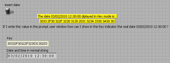

I have a problem with hex to normal conversion:
I have the constant string that is a date 03/02/2010 12:30:00 ( Normal display), if I use the Hex display it will be 3033 2F30 322F 3230 3130 2031 323A 3330 3A30 30
So I if  I write this Hex display of the date into a another string diplayed as normal, how can i convert this value to the initial date?

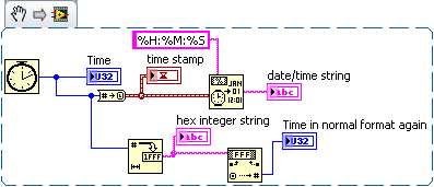

Hexadecimal String to Number vi should help.

The point is that converting the value in another format and displaying it in another format is not the same. You are displaying the value in HEX, but it is not in HEX as I understand. So you do not need to convert it, just set that another string indicator to display in normal format.
And if you have a string in HEX, then you can use the vi I have mentioned above.

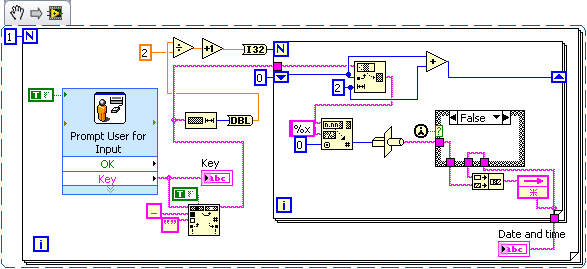

This is the beginning I have made.
There are two  drawbakcs:
1. No spaces in the input HEX code available.
2. The result is given with a space between every character.
This is how it looks like:
Maybe this will give you some ideas while moving on.

Accepted by topic author enzo78
Did the snippet creation create the for-loop with a constant of 1?
Now for the trivial solution:
  1. Right-click on the  Prompt User for Input Express VI and select "Open Front Panel".
  2. At the dialog click on the "Convert" button.
  3. In the new VI that gets created right-click on the "Key" string control and select "Hex Display".
See attached.

My solution with no drawbakcs.
Anyway, it is very possible that there was a more efficient way to solve this. While I am only a novice, this is the best what I have managed to come with 🙂
