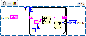

I have in 2 different traffic generators the input of source and destination address.
I need to read from a .txt file the desired addresses and then configure the generators. I want that the typed address in the .txt file will be in the same format as you can view in the generator interface (thats what I cant change)
The problem is that each one of them is using different arrays formats as input to the function, and I would like to read from the .txt file as a string.
For the first one at the moment I am doing like this:
and as I result, and is right, I have the array 0-0-0-0-0-3:
For the second one, when I type directly into the generator the address 00-00-00-00-00-22 , I will get on Labview an array 0-0-0-0-0-34, that I am converting to number as below:
as a result:
So, how can I convert 5_string.png, that will be typed in the .txt file, into the array above?
Thanks and I hope to be possible to understand what I need 🙂

OK, so see if I understand you correctly.
What you want to do is take the 12-digit MAC address strings (that you have already pulled from your .txt file) and convert them into 6-member numerical arrays?
If so, this will do that (once for each MAC address):
Now, there may be (probably are) other ways, and this may not be (probably isn't) the most efficient way to do it, but it will work.

thanks!!
it works fine 🙂

Hi tmarques,
now without loops:
When you need that loop you could use more simple string functions:
Message 10 of 13
