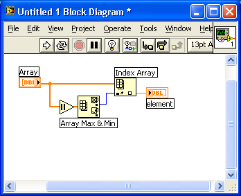

Ok all,
it returns just the magnitude not the nasty sign that is meaningless to the OP
Message Edited by Jeff Bohrer on 10-29-2009 11:30 AM

EduU wrote:
Yes, I already do it with absolute values
but If the "greater" value is the negative one.. I need to know that
so I have to find a way that it shows me if the number is positive or negative
I have "300 400 -500" with absolute values I will receive 500 as greater value
but the real greater value is -500 not 500
Please look at that sample code again.
The abs value is just used to decide which element had the largest magnitude. I then index out the original value as per your desire.
Ben

Well Jeff, this way still gives me only positive values
because x² make any negative number positive
I will try explain my point again
I have to get the greater number even the number is negative
and when i have that number i have to plot it with the signal
Like I have 5 numbers "100 144 -155 -200 -298"
The greater number is 298
so I have to plot it like: -298
If I use absolute values, ok i will find 298... but I will think it is a positive values
when it is a negative value
Now you guys understand me?

Ben's solution does that

Well the Ben explain is right..
sorry at the first time I saw I missunderstood it.
Really apreciate that... I thought for like 2 hours and don't figure out any way to do that
and you did it in 10 seconds haha
