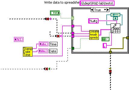

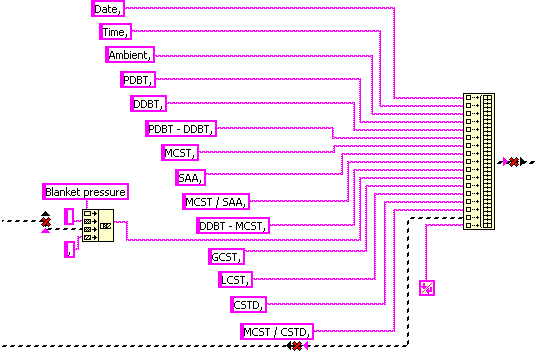

I have a similar problem.
I have a header generating sub vi and then this and data are to be written to a spreadsheet.
If I only write the header it works.  If I allow the vi to run and get data, I get no header.
Also all data is entered in the first cell, and the file is not a excel file.
I am using a comma as a delimiter.
I am not that experienced in Labview yet, but I don't see a problem with this.
Message 4 of 8
(6,047 Views)
It would be best if you started a new thread and posted your actual VI.  It is hard to debug a shrunken image of your block diagram.  And the assortment of broken wires don't tell us anything either.
Write to Spreadsheet file doesn not create an Excel File.  It creates a text file that is delimited in a way that a spreadsheet program like Excel can open or import.
If all the data is being entered into a single file, you probably do not have the import process in Excel looking at the correct delimiter.  I find with Excel you have to explicitly tell it to use a comman when you import the data.

Your replay tells me what I need to know.
No where did I find that the file is not saved as an Excel type file.
If I open Excel and then the file it's a bit differenct than if I open the file using Excel.
Sorry for the bad pics, but I don't have a way to make a jpeg.

Hi MrDoc
Could you post the vi's
so that we can understand your problem distinctly
Regards
Message 7 of 8
(5,977 Views)
Did you see some place that said that it DID save it as an Excel file?
To make a jpeg, put your screenshots into Microsoft Paint.  Then you can Save As to a JPEG.  Then attach that file to your message.
