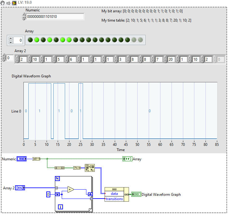

Here's an example. Optionally use Reverse 1D Array to get the MSB/LSB switched.

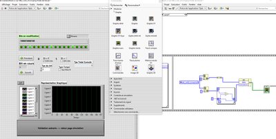

Hello Butcher,
Thank you for answer, that's good for me, but i don't have a good graph as yours.
This is my screen, and follow a part of my programm :
What is the good graph who must take to have a good chronograph as you ?
i don't want to have any line on the graph but something as you, so only one line who show the evolution my word, bit to bit on the time.
What is the solution for this.
Thanks by advance .
Have a good day.

The style of the graph is set by the type, I used a Digital Waveform Graph (NXG Style), but you have I guess the Modern one.
To set the line to take all of the vertical space, right click on left axis (around Ligne 0, inside the graph (not the side bar)) and choose Autoscale Y.
To remove the sidebar/panel, right click on the graph and choose Visible Items > (uncheck) Plot Legend.
