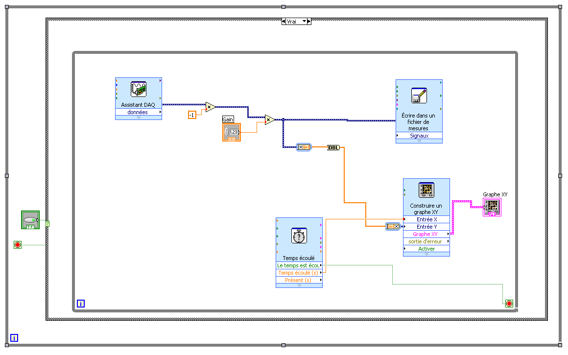

First, thank you one more time for your time. I had some trouble with this so I tried something that ALMOST works !! Here is it attached.
I Have a continuous evolution of the signal from 0 to 30s, and all I wanted is now perfect 🐵 I inspired from your solution to use a XY graph. BUT there is still a problem: there is an increasing delay between the signal and its display, i.e., when there is some tremor measured with the laser it displays about 3-4 seconds on the graph, and it displays more 10s after when the software runs for about 20s.... So it appears that there is an increasing delay between what happens and what is displayed. I recall that my data is acquired with N samples (10) at a frequency of 100 Hz.
What could cause this last problem? I'm pretty sure that it's about the XY graph which should be in a separate loop or something like that... (but remember that I want to display the signal instantaneously and continuously)
Thank you again in advance 🙂

there are a few things which strikes me as wrong in this picture:
1) you transfer from dynamic data type to 1D double array. then from double to double. then from 1D double to dynamic data type. why?
2) the idea of an xy graph is that for each y point you also have a x point. in this vi, for each array of y you give a single x point. what you will get is a list of (in your case 10) y points for each x position.
i think for now, try to stick to the waveform idea, since you do not have such x array, but have the interval value dt.
how to do:
- transfer from dynamic data type to waveform and decompose into Y array and dt. insert the y array into a bigger 1D array, updated using a shift register as shown before.
- take the outcoming big 1D array, and recompose into a waveform. update dt from before. display in a waveform graph.
should be ok.

You are absolutely right for the first point !! I tried 100s of things so I made this useless thing. So ok for this. However, in your example, you give a waveform, then extract Y and dt, but as I need to provide a Y and dt to build a waveform from my dynamical data, I do not see the point...Furthermore, I do not see what exactly is what I underlined in black on the attached image of your example.
Then, I do not see what you mean by "update dt from before" :-s Could you please draw a quick thing based on my graph?

this is called a shift register. you need to pass trough Labview basics i think.
right click on the while loop, and press "add shift register". to this you can wire from inside the while loop any data to the right, and it will be available at the next iteration of the loop on the left side. this register is a way to update a value or array during loop iterations.
at first iteration this shift register generally requires initialisation (initial value, which in your case would best be an empty array).
now in the loop, what happens is you take this array, and append to it the data you just aquired with the card. you cannot append dynamic data, and thats why you need to decompose and get the 1D array.
then you take the whole array and display it in a graph. since you do know the interval between the y points, it is just natural to use a waveform graph. for that you need to compose the waveform from the y array, and the dt (time interval).
every iteration of the loop, the whole array gets updated with the appended new data, displayed in the graph, and passed trough the shift register to the next iteration.
try to look how it is done with my figure, and reproduce it in your system.
post your vi, and we can also work from there.
