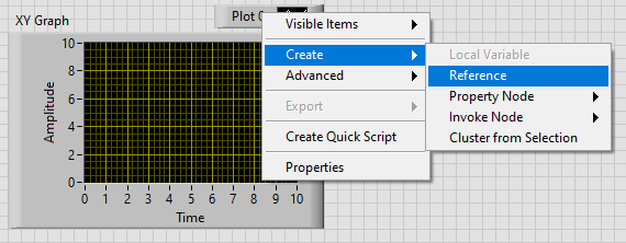

Add this key to your LabVIEW.ini and restart LabVIEW:
AdvancedPlotLegendMenu=True
Then you can right-click your legend and create a reference / property node / invoke node to it:
If you create a reference, you will get an unnamed Array reference.
By inspecting its element, then the cluster elements, you can get the ref to the plot name string:

Thank you very much!  This worked perfectly, but what a lot of work just to change a font size.  I am really surprised that this has not ever been addressed before.
