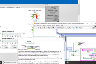

Yes this would work if the target was Windows, and running on that Windows target. But I have a remote Linux RT target, with the main host program on Windows. So I will connect to the target with WebDAV, and from there I'd like to know if I can get the Creation Date, of that remote file. FTP for instance can read the Creation Date, and the last Modified Date of these remote files but I can't seem to find a way to do this with WebDAV.

Using "File Info" from the open G toolkit seems to work on my CRIO-9035. Albeit the date is 2 years out.

Again, this isn't what I'm asking for. The VI will not be ran on the target, it is being run on another target, asking for the file creation of a remote file. Here is a picture.

That's what you get for password protected panels. Although I'm not quite sure if it would help as the VI most likely simply calls into resources/ni_webdavLVClient.dll and most likely does all the handling in the DLL.
Basically there is a webDAV property "creationdate" that is supposed to be available in the according WebDAV HTTP XML response. While parsing XML formats isn't really trivial it may have been actually more helpful if the WebDAV extension was built around the HTTPClient library rather than pulling another open source C code into a NI private DLL.

Yup. The Path Info function just calls the ni_webdavLVClient.dll from the resource folder with the function call of ni_davg_start_path_info, and then ni_davg_finish_path_info. No other functions seemed like an obvious choice. It is possible NI hid some function inside the User Data Variant.

I have no other recommendation. It seems impossible to get at the internals of that handling. And I don't quite have the time to implement a WebDAV library on top of HTTP Client, as tempting as such a project may sound.
