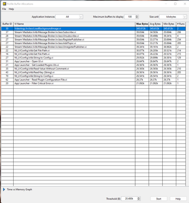

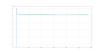

I whipped up a small python script that measures the amount of private memory dedicated to the exe every 5 seconds, and let it run for an extended period of time.  I then whipped up another script to help graph it, and I got the following
Which doesn't look too bad till you zoom into the "flat" part and see
The Y axis is in Bytes and the X axis is in 5 second intervals.  The Blue Line is the actual data, The Green Line is a line of best fit for all of the data, and the Turquoise Line is the Max value (so I can see if it's growing or not).   So yes it's not a very fast increase in memory, but it is steady, and since this application is supposed to be run months on end, that time adds up.
As for the Profiler, I attached the Memory Profile, and got the following for the buffer allocation
Thanks again for all your help!

IMHO you are looking at noise here.
So you have an application that on startup jumps to 9*1E8  bytes of memory, falls back to 8.119*1e8 bytes and then slowly increases to 8.126 * 1e8 bytes with a clearly visible asymptotic curve.
That is a jump to 900MB, then going down to 811MB or so and then slowly and asymptotically going to 812MB over a period of 10000 seconds. This is crazy constant for a memory footprint! If that's your only problem for this app you are done! And yes even if you let this run for a month. Unless you can show us a continuous linear increasing memory line, there is simply nothing to be seen here! Please move on!
