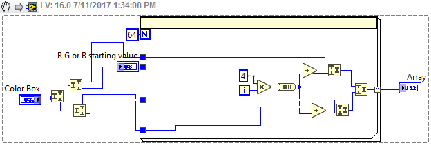

Its easier to do if you think in HEX
Splt numbers is your friend here take a color box constant split it into 2 U16s  Split those into 4 U8s Ignore the highest (it is 0)
Pick one R, G, B to remain constant  Red is the second U8 Green the Third, Blue the least significant.
Run the other two though something like this
Then join the numbers again (00-R & G- B to u16) and (00R-GB to U32) Bobs your uncle
You can play with inconsistent treatment of the tow variable colors.  You might not like it but it might be psychedelic.

I have taken a slightly different approach that what Jeff illustrated.
Yes start by splitting the colors into RGB values. Then create a ramp first between Red-Start and Red-Middle (do the same for the G and B) and then generate the ramp for Red-Middle to Red-End (same for the G and B).
Concantenate the R-ramps (same for G and B) then use the three resulting arrays in a For loop to "Join" the RGB back as colors.
No psychedelic effects and nice smooth color ramps.
No need for the FOR loop.  The Join Numbers will accept arrays.
Otherwise, my solution would be similar to what you already described.
