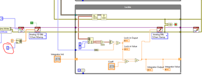

It's possible I'm still missing a key detail (especially relating to synchronisation, phases, ensuring sync, etc) but could you try the following?
Here only the bottom loop is shown, but the key change is removing the Start/Stop cycling and instead using Regeneration and Continuous Samples to ensure you don't have a problem if the bottom loop doesn't receive a new value quickly enough.
Probably you'd want to implement some sort of sync between these loops (or maybe just move them into a single loop? Hmm, that usually causes more problems, but it might work here?) but this works with the hardware you're using in a simulated sense (which of course doesn't tell us anything about timing, but does validate property node usage etc).
I've replaced the queue with the DBL datatype to simplify the bottom loop (I also had to implement an In Range and Coerce function in the top, because the simulated DAQmx has values out of range for the output otherwise).
My modified VI is attached (backsaved to 2016 like Kevin's, on which this was based).

I think my alternative in the previous post (I guess I was writing as you posted this, so I just saw your responses) might help with the 'dead-zone', but you'll have to check carefully synchronization.
If the processing in the top loop is slower, maybe move it back to the bottom - I moved it mostly for the screenshot simplicity, but obviously that's less important than a working VI!

Actually by using regeneration and continuous samples, the problem is solved. Meanwhile, as Kevin points out that there seems to be a minimal size of the buffer. What I found is that the analog write function outside the loop requires an array with minimal 2 samples, while the analog write function inside the loop can be set either 1 samples or multiple samples. This may be device specific, but for now the program is working as intended. I have tested the speed from 1 iter per sec to 100 iters to sec and they all work perfectly.
Finally, here is code that works.

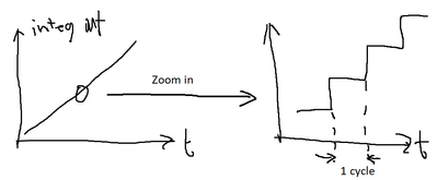

1. Sorry I have misled you about the dead time. Let me explain by the following sketch.
Left is the output of an integrator assuming a constant input. And if we zoom in we will see that the curve is in the shape of a staircase because the output is updated once every cycle. What I showed in the previous post is the waveform of AO in ONE cycle. So if it works as expected, we would see a flat line in each cycle(This is what I observe after I fix the code following cbutcher's advice). But what was strange was that using the previous code (finite sample with start and stop in each iteration), there was a period when the AO is zero. What causes the output to return to zero is something I don't understand.
Although I have a working piece of code now, I'm still curious why the previous code does not work.

The "dropout" down to 0V output is showing you the time when the AO task was interrupted and not running.  This is a characteristic of Delta-Sigma D/A converters.  I wasn't thinking of this before, it just came back to mind now.  (Many of NI's other common devices buffer and hold outputs so their final voltage is retained after a task stops.  I've dealt with those a lot more than with Delta-Sigma D/A's.)
The spec sheet suggests about 31 msec of Delta-Sigma filter delay with your 1000 Hz sample rate.  That appears to explain almost all of the observed dropout period when you ran my code with the "commit" action.  Whatever little bit is left would be the (now smaller) stop/restart overhead.
But even this somewhat brief dropout is no good for a control app.   I suspect cbutcher was ahead of me in considering the Delta-Sigma dropout when he set up the continuous task that's working for you.
