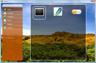

Recently I saw GUI of Ubuntu netbook remix. it so cool that I wanted to have something similar for my labview application. I have successfully developed it.
I am just sharing if somebody wants it, also I would like to know more ideas about improving it.

Very nice Tushar!
Not that it needs improving, but since you ask for ideas here's a couple:
  1. If you start with a system boolean button instead of a modern or classic button you'll get an additional mouseover state that you can customize.  This will let you easily do mouseover effects.
  2. Placing a background image as an image on the front panel has the undesirable side effect of making it very difficult to open a palette (since you can't right click on any empty space).   I like to set my background image as the panel background (right click on the scrollbar and go to Properties to set a panel background).  This gives you the alignment grid and easy palette access when you are in edit mode that you miss by having a background image decoration.
Keep up the good work!
~Simon

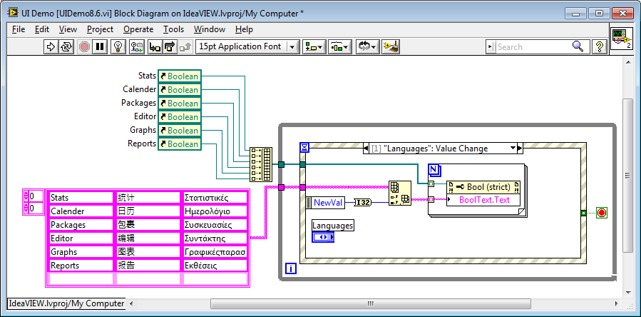

  1. Depending on your audience, perhaps the best improvement you could make is on-the-fly translation capability. This is a rudimentary example, but a more sophisticated language management system can be easily achieved with an action engine or class. Keep in mind, LabVIEW uses UTF-16 (UTF16) Unicode, whereas the de facto web standard is UTF-8 (UTF8). (I have hijacked the last tab, 'Reports', and the three options, the 'O', the Canvas, and the Brick Wall change from English to Chinese to Greek respectively)
  2. Choose descriptive names for Tab Controls and Radio Buttons, rather than "Tab 1, Tab 2, Tab 3..."
  3. Don't wire the timeout case in a UI structure unless you need a polling mechanism! Attached diagram responds much snappier (previous response time was random between 0-500msec, now it's always nearly instantatneous). For anyone listening, and this is important: If your Timeout Case is empty in your event structures, it's OK to delete it!! This way you're not stuck between some event-driven/polling architecture, but purely sticking to event-driven.
  4. Consider using a Picture Control if you want the background to be loaded dynamically, and consider a picture ring if you would like static background options. Remember to consider the size (bytes) of your application, however. Large pictures easily eat up a larger footprint than the app code.
  5. You are a very talented artist.
17497i46D4AE428F9C295B
17499iA3C9522B826955D4

Nice graphics.  Very cool looking.
Now what do I do with it?  Smiley Very Happy

@ Simon H
I really didn't got your first comment my controls are currently supporting  mouse over effects. And if you see the control it is also having 6 images instead of normal 4. Can please elaborate your point
second point was really great idea and I have implemented it.
@ JackDunaway
Thanks for your comments. Actually I never thought of supporting multiple languages. However now I will think more on those lines as well
