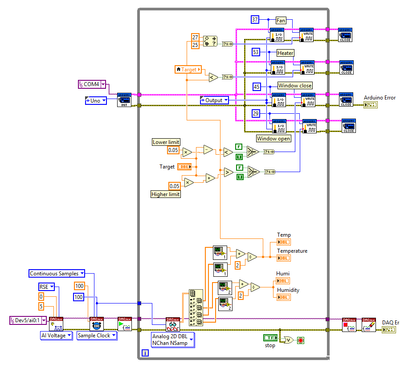

Greetings. I am sorry because I am continuing this conversation. The problem was almost solved, but I couldn't solve one issue yet. The attached LabVIEW code is working well, but facing problem during controlling the window opening/closing motor. The window motor takes 2 minutes to open/close the window fully. But the inside setup takes 5~10 minutes to reach in the target temperature level. As a result, the window motor keeps working (more than 2 minutes) and breaks the window frame. In this situation, how can I control the time limit?

Greetings. I have attached a picture of that LabVIEW code here. Would you please take a look? Thanks in advance.

Hi Milon,
all I can detect in this image are those two classic Rube-Goldberg constructs!
What's the point of those Select nodes with TRUE/FALSE inputs? This is just a NOT! And you don't even need a NOT when you use other comparison functions upstream…
Why do you need a local variable of "Target" when the terminal is just 100 pixels away? Are you run out of wire?

Mr. GerdW
Thanks for your reply. 'How can I manage the time'-that was the question, as I can't allow/run the motor more than 2 minutes. Would you please focus on this issue?  TIA
Message 9 of 10
(3,135 Views)
Hi Milon,
I don't see any timing on this image.
The loop certainly iterates much faster than once each 2mins, so it should be easy to control the motor…
