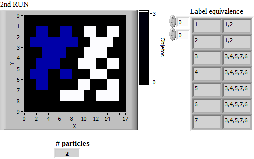

I implemented an algorithm for counting and labeling connected components in binary images (LabVIEW 8.0). At the end of programming I inserted a tab control (changed to indicator) and copied some images into its pages for future reference. The VI worked fine until I close it. When I try to open it again, I get the following messages: "Save/load error: Unknown error" and "Save/load error: Improper format". The VI can be inserted into another VI and the code runs, however I cannot have access to the front panel again.
Does any one know how to get access to the front panel and fix this problem? Thanks!

Your vi opened smoothly in LV9 (although a subvi is lacking). So I saved it back into LV8.0. I hope you'll be able to access th FP again.
I also had a look at the diagram. Seems terribly complicated with regard to the result. What are you trying to achieve ?

Dear CC,
Thank you for your quick reply. I am trying to isolate regions of a 2D histogram converted to binary contour plots. The VI was tested with a simple example to verify its labeling accuracy.
Regarding the VI, I still cannot open it (still get the same error message). As the problem appeared after insertion of the tab control and the images, I wonder if the deletion of such indicator will fix the problem. Please, save back to 8.0 again.

Accepted by Arthur S.Ferreira
done...
Chilly Charly    (aka CC)
Message 4 of 9
(6,621 Views)
Thank you  you, it worked.
