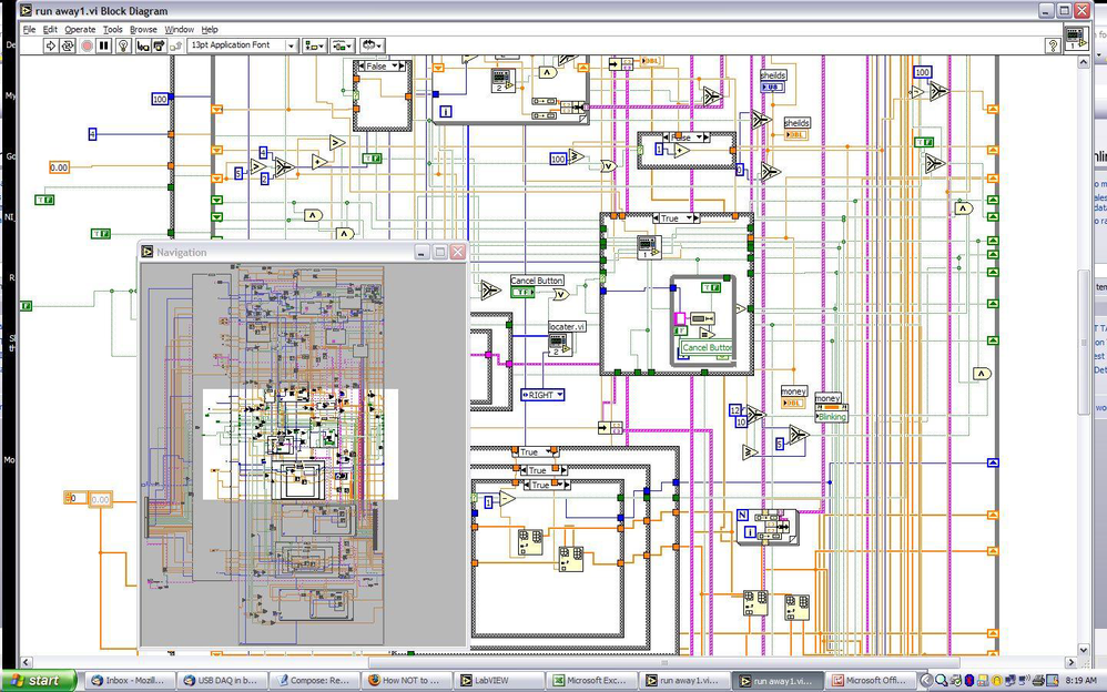

This is why we can't have nice things, this is why LabVIEW gets a bad wrap for not being a proper programming language. This is why newbies want more 'Control and Indicator' References. This is how to properly implement Local and Global variables in LabIEW. This is why you need dual wide-screen monitors to program effectively in LabVIEW. This is why you need a ball-mouse.
