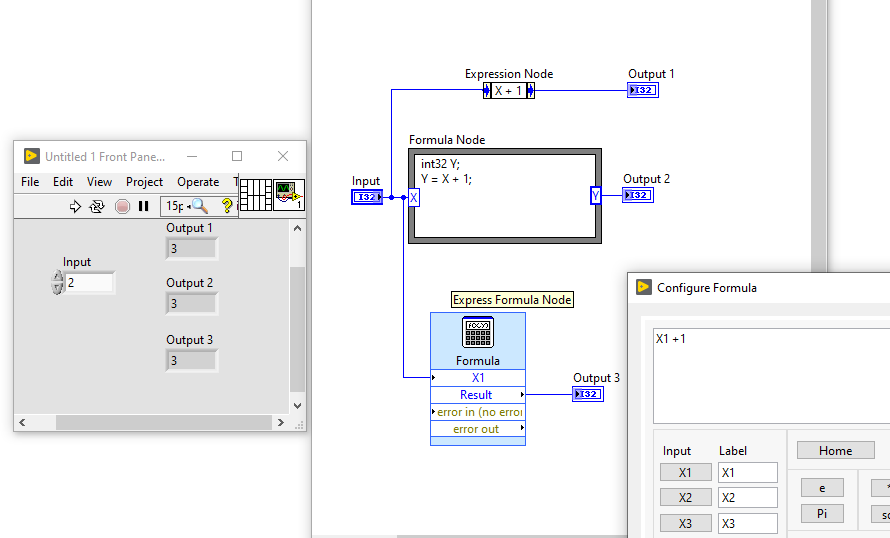

I entered a formula with several variables with no problems (all green) but how do I define the variables outside of the Formula Express VI, since it has no inputs to wire up, other than the error in node. I tried using indicators and naming them same as my labels but that doesn't work and I can't find any examples. Thanks for any help someone may provide.

You would need to attach your VI for us to debug.  But it is sounding like you didn't name things correctly.

I have never use the "express" version before, but looks like you can have only have a single line of computation.

Thank you. I was able to fix the issue. The problem was that in the Express VI formula box I had: "Kxx= f(x1,x2,x3,...)" just like I have done with a formula node (which I am not using since my data is dynamic data). Anyway, when I replaced that with either "= f(x1,x2,x3,...)" or simply
"f(x1,x2,x3,...)" then it worked fine and the Express VI icon was then populated with the inputs which were not there before removing the "Kxx" or "Kxx=". However, in all three cases the formula showed up as a valid formula, indicated buy the green box. Kxx was defined as a variable in all cases.
Thanks for you help and prompt response,
