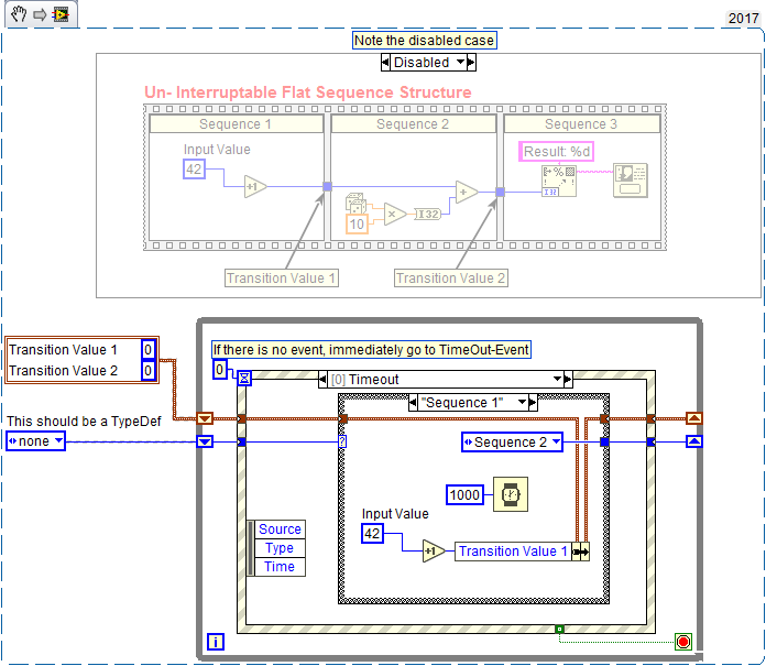

I have created a program which has a lot of flat sequences (As shown in below image).
But the problem is that i could not stop these sequences whenever i wanted. Because, when I am in the middle of sequence, even I press stop button, it does not work. I searched on this forum about solutions, everyone is suggesting to use state machine. My question to you is that, how can i transform this flate sequence to a state machine which is not controlled by any events. These flat sequences contains a set of tasks which should be performed one after another, without any external command. I have created a sample program, just to show the flat sequence which I have to use (Or alternatively state machine) to ensure running of tasks in sequence. Kindly guide accordingly...

As a start, I made a little example of a conversion from a flat sequence to a state machine.
Greets, Dave

Accepted by zahidkjatoi
Using the example already posted as an idea - there is no reason the states have to be linked. Attached is a VI with 3 steps all just performing addition with no communication between states, using a 0ms timeout event structure.
With regards to producer/consumer, the idea often involves a Queue sending the states all to the consumer to carry out when you press "start", or similar. If you need to stop after a state that is in progress, you can enqueue from the opposite end. This becomes more complicated when you want to for example save and stop - then you have to reverse the order of the states that are enqueued, but that brings its own problems.
