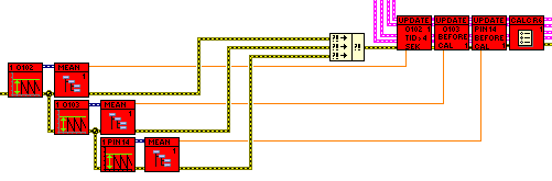

I was working on a report generation vi for my project, and it has grown way too stacked. Loop within case, within sequence etc.
To keep a large VI tidy I was using the cleanup feature.
After another cleanup my 2 stacked sequences and 1 while loop became "bugged".
I tried to restart both labview and, later, the PC. Bug did not disappear.
Is there any way to fix the bug? I tried to replace structures with alternatives from right click menu. After few conversions the problem is not seen, but shortly appears.
Any way maybe with HEX editor?
Flat sequence thinks it has a stacked sequence wall on the right side. Mouse can't be seen on screenshots though.

Another screen and the VI.
VI will run but it requires the project in order to run completly. It will run into an error if you try to press buttons...

Part of your problem (beyond what others have said about the architecture of your program) is that the diagram is too large.  In older versions of LabVIEW block diagrams more than about 15000 pixels wide would become corrupted, usually irreversibly.  Your diagram is over 30000 pixels wide.  NI must ahve changed something in a recent version to even allow a diagram that large.
You really need to start over.  With some luck you may be able to recover enough of the pieces of your program that you do not actaully heve to rewrite everything from scratch.
Tread very carefully!!! Make two or three back up copies.  Then start copying out pieces (like the contents of one frame) and make subVIs, even if they are not the most logical.  Save another copy every few minutes.  You are likely to have crashes, lost work, and corrupted files.  When you get a piece that seems OK, save it separately.
Now is a good time to learn to do it right.  You have to do it overanyway, so fix it as you go.

There's a limit of 16k pixel wide diagrams (or something), you're not hitting that limit?

I, in fact, hit the 16000 pixels limit with my event structure, not without the help of clean-up feature.
The code is salvageable, and its good to know that this is the cause, now i know what to avoid...
At first i was trying to reduce the the levels of containing (structure within structure etc.), with no success - the bug returned.
BTW, when trying to create 16K++ long structure, LabView allows this, but will coerce the size on resize attempt. Maybe when cleanup system tries to expand the structure beyond 16K, the bug occures.

I tried to move your structures around, but this happened:
Clearly this happens because of the massiveness of your VI. Luckily I was able to see the whole thing on my 1789 inch TVSmiley Very Happy
