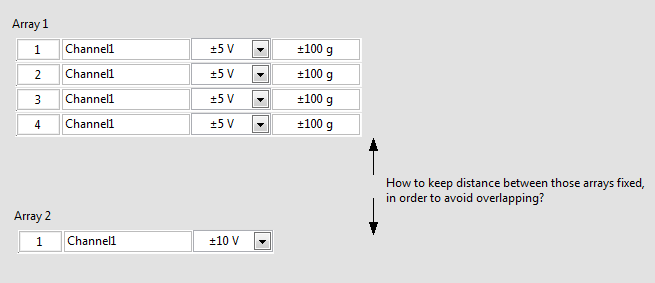

I have two arrays expanding depending on the values. If the arrays contain a lot of elements, these two arrays overlap, please see below images.
How can I keep the distance between those two arrays same, in order to avoid overlapping? These arrays are in a tab.

You can do this programmatically, but not in development mode. If the arrays are expanding depending on the values, does that happen programmitcally?
You can pull a control's location and bounds using a property node. There's a section of properties in the list that contains Position, Bounds, Master Bounds Rectangle, etc. that can tell you all the info you need to offset the second array. You should be able to pull the Bottom value from Master Bounds Rectangle, add an offset, and set the Position of the second array.

Nice... Thanks James. I have couple of front panel images and texts which I use as labels-captions though. I have to put them into picture ring or something to use position property...
I use "Group" tool a lot, that's why I was asking about the "distance" actually, not control positions... Anyways, I am not willing to get lost into this, thanks for your reply.

Ah, yeah that's one disadvantage. I think it's an oversight by NI that grouped Front Panel items don't move together when positioned programatically like this.

Nevermind! I just realized you can do what you're trying to do using a customized control. Right click your array and go to Advanced >> Customize. Within this control front panel, you can add your caption texts, or images, or whatever and they will always move with the control just like a caption. You don't even have to save the control to file unless you want to duplicate the added captions elsewhere.
