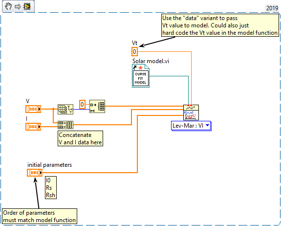

I think it is possible to sidestep the transcendental part of this problem entirely. As I understand it you are not trying to solve for x if given y, or y if given x. You are trying to find the parameters of the model that best fit your equation. So perhaps rearrange your equation slightly by subtracting I from both sides and call the left side Y, recognizing that Y should always be zero:
Now treat this as your model for curve fitting. You will have an array of Y values that are all 0. I and V are treated as your X input to the Nonlinear Curve Fit.vi
Nonlinear curve fit.vi only allows a 1D array of values for X and Y, but does not check to make sure they are the same length (Thanks Christian!!!), so this allows you to concatenate your V and I arrays into a single "X" array. Below is a snippet that shows what I mean.
Now your model must unpack the X array so you can evaluate your model.
So the nonlinear curve fit will adjust the model parameters to make the model as close as possible to the Y values which are 0. This is the same way that we solve for a best fit circle or ellipse using Nonlinear Curve Fit. Ellipse fit is a shipping example (...\examples\Mathematics\Fitting\Ellipse fit.vi), but the code is a bit harder to read and the modeling aspect of the problem is not explicitly called out.
-Jim
While that will give the best fit parameters, there is still the difficulty of graphing the original data and the corresponding fit on an "I vs. V" XY graph. For that we can still use my suggestion above.
On a side note, I would simplify some of the details (fewer primitives and coercions). I doubt there is a noticeable performance penalty. In most cases, we don't even need the FOR loop in the model, of course.
