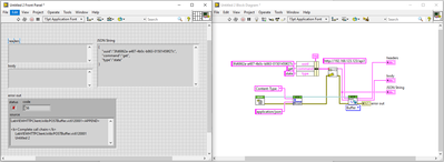

First time using ethernet communication (JSON). I need help please thanks
 so i tried this code and i'm having trouble. i'm not sure what should i put in the buffer url. but it's the right ip address. also provided the knopp json functional command. i'm not sure what i'm doing here. does the equipment seller needs to provide the url part? i don't know. thank you guys i hope you guys can help me out. i really appreciate it. please let me know if i need to provide more info.

The code you posted is attempting to use the RESTful API, but looking through the PDF you uploaded it is just standard TCP/IP communications, not RESTful.  Take a look at the TCP pallet under Data Communication > Protocols.  You probably want to do something like this:
