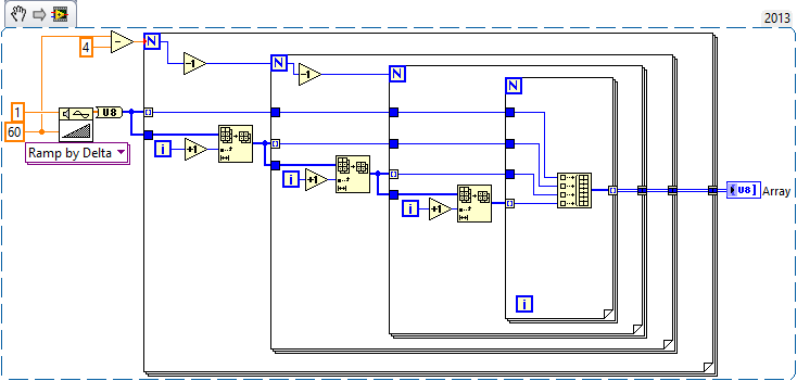

It seems easy enough to brute force. 🙂 If i'm correct the answer is 521800 combinations. (Hmm, I see a mistake now, let's see if you spot it)
/Y
Qestit Systems
Certified-LabVIEW-Developer

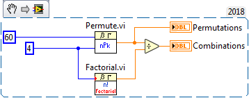

Why reinvent the wheel. You can always use the built in VIs
btw the answer is 487635

Counting the number of combinations and generating an array containing all possible combinations are two different things. Do you really need the output all at once or would it be sufficient to generate and process one at a time without having a hardcopy of all of them at the end?
In any case, definitely don't do this in SGL. As Yamaeda demonstrated, U8 is plenty to uniquely define the index of each of the 60 elements.  Personally, I would probably do it a bit differently, but I don't have time right now to look into it in more detail.

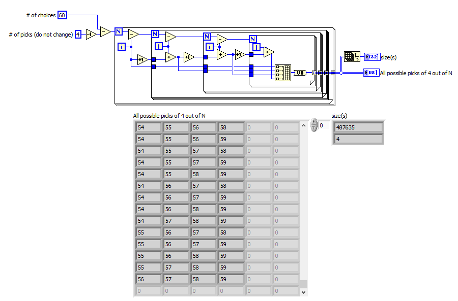

(Finally got off the bus and had a minute to show what I had in mind...)
Here is the "dumb" code that seem to also give 487635 possibilities in agreement with jamiva. No guarantees. Maybe it can be simplified?
Now "smarter" code would use a single loop and allow the number of picks to also be a variable input. Scalability is the key here!
Try it 😄
