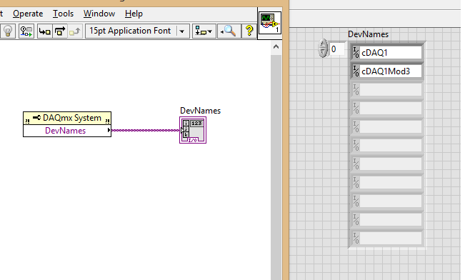

Hmm for some reason it won't populate the cDAQ device in the "session in" I/O constant.
It only populates the list if I place a DAQmx Device Name constant, as shown in the bottom of the code.
The only way I have been able to programatically determine the devices is the following:
I guess I can use a simple regex to grab anything called cDAQ1Mod*
Cory K
Message 3 of 10
(6,678 Views)
Alright, I used the following code to generate an array of all of the modules that are present.
Now I just have to figure out how to create a task on the fly.
I think when I was watching the device in MAX, any channel that has a gage gives a reasonable reading.
Any channel that is empty just gives a maxed out value (such as 59,000 microstrain).
So once I find a module, I can just check every channel to see if it's value is above some threshold, like 10,000 microstrain.
Do you know how I would go about creating a task if I input the device from the above code? I have only done this in MAX, not actually coded it in LabVIEW.
