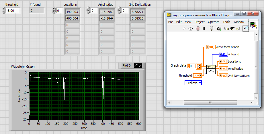

Hellow friends,
I am a newbie in LabVIEW. I use LabVIEW 15.0.1 and I am currently working on the program that analyses nine ROIs from the series of recorded images. I am able to display the waveforms from every selected ROI. I can also pre-process the signals, apply FFT and display FFT results.  But I can not display the Heart Rate from the Peak detector. I don't know what goes wrong with my coding.
I have attached my vi for further assistance. Please help.
Thank you!

Hi John,
why don't you use a simple peak detector?
I made a constant from one of your graphs, then applied a peak detector to find the peaks.
From peak locations and your sample rate you can calculate the heart beat frequency!
