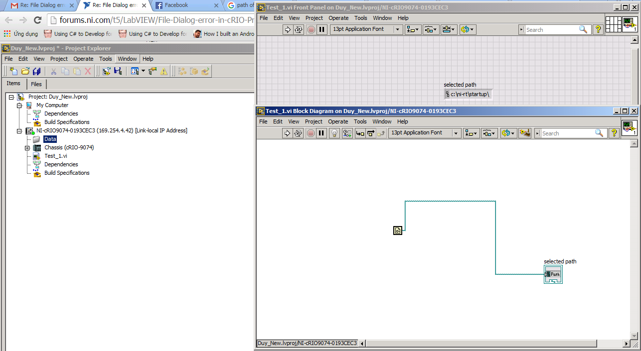

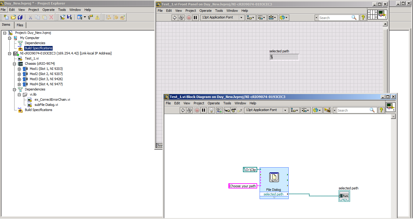

I am working on a project with CompactRIO but I got a problem with File Dialog.vi in LabVIEW. When I put my *.vi outside of the Hardware (cRIO) it work properly. But when I put my *.vi inside the cRIO, nothing happens. Please help me with this small problem.

Hi d4,
you forgot your cRIO is a computer of its own! And you forgot it is "headless"!
- The cRIO has NO ACCESS to the harddrive in your Windows computer so it just don't know where to look for the path "D:\…"!
- The cRIO has NO MONITOR ATTACHED so it cannot even display a FileDialog (or any other UI at all)!
A VI always runs in the context of the hardware target it is located in the LabVIEW project.
And such VIs have to obey the limitations of the hardware target they are run on…

Hi d4,
what is a "virtual" folder? Where is the folder located?
- With a cRIO you can use any folder that is present in the cRIO file system: anything under the "c:" path. (Use MAX or a webbrowser to check the file structure in your cRIO!)
- With a cRIO you CANNOT use any file dialogs as the cRIO has no display or UI - you most likely will use a constant path (or a path generated by algorithm).
- With a cRIO you CANNOT access your PC's harddrive…

The "virtual folder" means "Data" folder as the below picture. And when I check the "Current VI's path", it shows me that "c:\ni-rt\startup\Test_1.vi". So the path of "Data" folder is "c:\ni-rt\startup\Data", right?

Hi d4,
the virtual folder in the project is not related to a path on the cRIO.
In my cRIO projects a I also use virtual folders in the cRIO part of the project - and they all just collect files located on my development PC…
When you want to access certain files (like configuration settings or similar) you can include those files in the AppBuilder settings for your RTEXE. Then those files will be copied to your cRIO, and are to be found at c:\ni-rt\startup\data. (I'm not quite sure on this path right now, as currently I use a cRIO9066 employing a different file system.)
