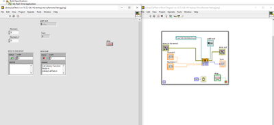

This is what I was originally using:
Then I checked the specify path on diagram and played with the paths, but the addition was no longer working.

It allows me to run it if I have a specific path into the CLFN, but then it does not function properly. Here is an updated SS:

The VI is returning Error 7 at the Call Library Function Node using LabVIEW, indicating that the SO library is missing. Are you sure that you have transferred the library to the RT target? Did you use Web Server from NI MAX or FileZilla to transfer the file?
