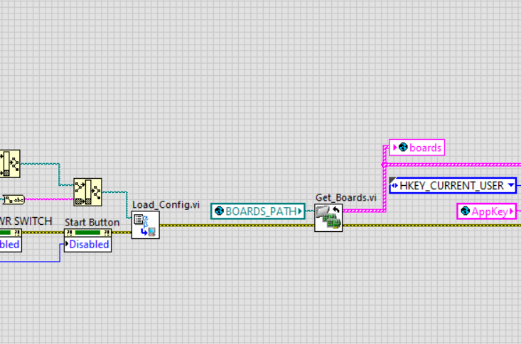

I think I'm having a problem with global variables.
I have a big number of global variables defined into parameters.vi.
Among these parameters I have BOARDS_PATH, this variable is the folder where I have to look for some xml files.
BOARDS_PATH value is changed by Load_Config.vi that reads values from .ini file and set BOARDS_PATH variable
(among the others).
BOARDS_PATH is used by Get_Boards.vi to create an array (Boards) of values I will use to look for specific board profile.
This's the main vi section where Load_Config and Get_Boards are called.
Load_Config.vi do something like this, the stacked sequence is repeated for each possibile entry in the .ini
file (there's a better solution?).
If I debug the main vi global values are correctly set BOARDS_PATH is consistent.
If I run the main vi without debugging it or if I compile it and run the binary then BOARDS_PATH is left at the default value (without any visible error).

Welcome to Race Conditions.
In this case, the easy solution is to send out the path as an indicator and wire it directly to the next function.

how can this code being subject to a Race condition?
Load Config and Get Boards are run sequentially .. if they are not how can Error in -> Error out be kept consistent?

How old is this code?  The SSS should be beyond your reach.

You need to execute your load config before reading any of the Global Variables.  In your screenshot, you have written code to read the global variable first.  Put a sequence structure around the Read, with an input error wire to enforce the execution order.   Remember, LabVIEW code does not necessarily execute left to right.
The Global is read before it's written since you have nothing that forces order.

Accepted by topic author michele.santucci
I know it's ugly but this way it will work:
Yes, that forces order. But it'd be easier to just wire it from the previous VI. 🙂
