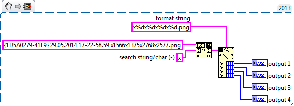

I have image files and I want to extract the nuumbers in the image file name. All my image files look like this:
I want to just extract the number after the first x and the second x. I have tried using Match Pattern and then converting them with Fract/Exp String to Number but the output is not always constant of the position I need. How would I go about this?

Accepted by topic author PauldePaor
How about using "Spreadsheet string to Array" like this?
(9,485 Views)
or this way,
btw: I wouldn't use special characters and dots in file names.
