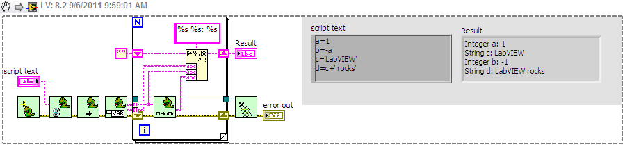

Here's where I ended up after asking a question on LAVA.
Jim
Message 3 of 22
(5,939 Views)
Jim
Message 4 of 22
(5,928 Views)
I'm curious to know if this is useful for your application.  I've seen this use-case suggested in the past and I'm interested to see your solution.
This solution requires you to install Python and the Lab Python tools, but it adds great flexibility in handling your dynamic formula input.
Jim
Message 5 of 22
(5,901 Views)
Or this, which more closely answers your original description.
I'm having fun.  Anybody?  Anybody?  Bueller?  Kahr?  Anybody?
