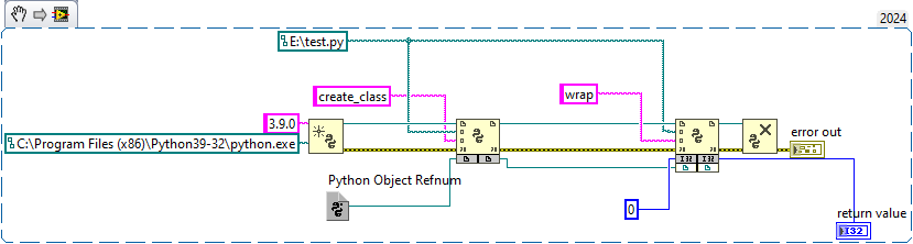

Make a sample python code with the function defined by async def inside a class.
I tried to execute it and get its return using LabVIEW but I got the error as below.
Do you have any solutions for this case?
I appreciate any helps from you.
Thanks.

What is the main() method supposed to do, its not called, maybe you mean to call that method?
Does this run in python?

I just removed the above execution line because I don't think it is useful for my check. So please ignore the main().
I'd like to execute the function example_coroutine defined in class A and get its return.

The way you call the wrap() method will only return a ref to the coroutine not start the async loop.
You need to start the async loop, once the async loop is running you can await methods. Check this out:
https://docs.python.org/3.9/library/asyncio-task.html#coroutine

Could you give me a quick solution for the wrap() so that I could call it in LabVIEW to get the return in "async def" function?
I am sorry, I am not familiar to Python much.
(2,346 Views)
Hmm, well this is not the best forum to lean Python, and you really need to lean some basic Python before diving into the asyncio library. I will post some Python below to get you started but I think you will find that the asyncio library and the LabVIEW Python VIs are somewhat at odds with each other when using the asyncio library. LabVIEW can execute VIs in parallel but calling the Python node in LV is blocking and there is some irony in using one parallel executing program to make a blocking call to an asynchronous library of another program. If you really want to link LabVIEW and Python asyncio you need to set up IPC between the two programs so the message loops in each program can run in parallel. Why are you trying to use asyncio, do you need it? Well here is some toy python asyncio code to play with:
