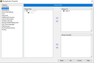

Rajsakthi_1-1707472753576.pngRajsakthi_2-1707472773020.pngRajsakthi_3-1707472815063.png
This is what i done to build an EXE. when i tried with another laptop it is not working.
What is not working?
Any errors? Does it behave incorrectly? Does it crash? BSoD?
Tell us what's happening and what you expect.
If the problem is in the code, we need to see at least the part that gives the problem.

@Rajsakthi wrote:
Actually the program is executed perfectly in the LV development environment system. when i convert it to EXE the data reading is not taking to the application.
The other application what i have developed is working perfectly in other laptop but the program contains subvi is not executing.
We can't guess what's wrong from only that description.
Relative paths change when building executables, especially if you use VI paths...

Accepted by topic author Rajsakthi
To clarify, problems occur is you use "current VI path" incorrectly (details).
Looking at your build specs, I very strongly recommend that you don't build to a destination that is monitored (Onedrive, google drive, etc.).
