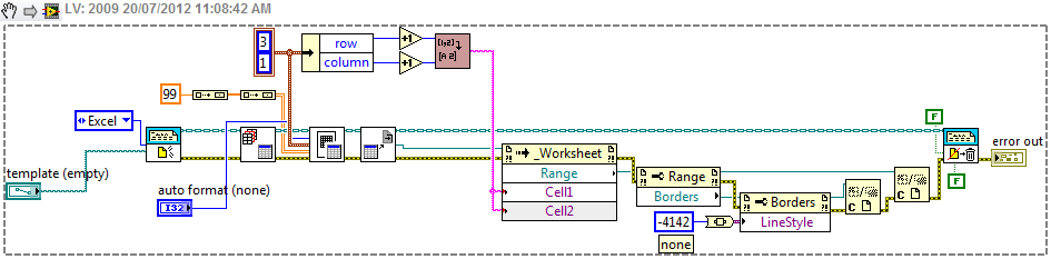

I have to say I was waiting for this question (I have tried it and observed the same thing). The only solution I see is to use a combination of the RGT vis and ActiveX.
Ben64
note, I have connected Cell1 and Cell2 of the _Worksheet Range method but it is probably sufficient to connect only Cell1 here.
edit: Good, your solution seems a lot more simple!
