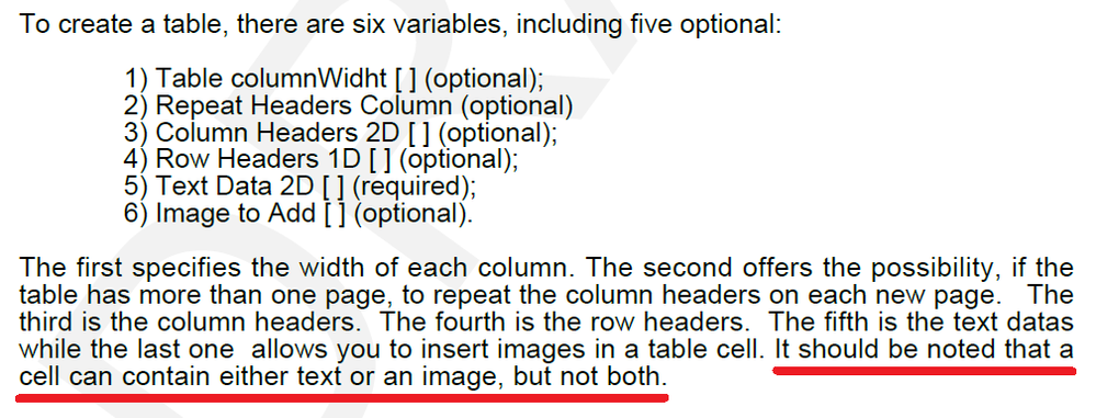

One more question, place an image inside the table cell works perfectly, but
is it possible to have text and images together inside the same table cell?
In affirmative case, which is the image placeholder?
Asper
(5,420 Views)
No it is not possible with this toolkit (User Manual - page 17):
In fact, with iTextSharp it is possible to have "text +image" in a phrase.  We could put this phrase (text + image) in a table cell but, you have to modify the toolkit and it is not small modifications...
(5,382 Views)
Sorry, I have missed the underlined phrase!
Thanks again,
Asper
(5,368 Views)
