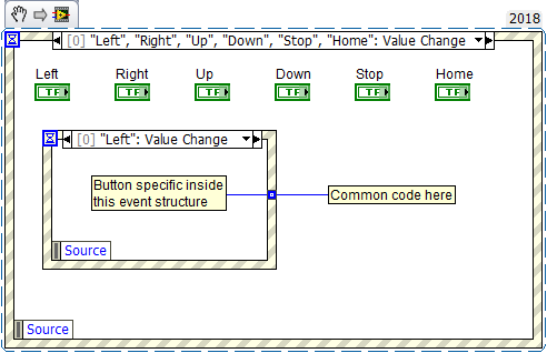

Just put the buttons in a Radio Buttons cluster that allows No Selection.  Then do this:
Message 6 of 10

@mike-o-tronic wrote:
I love the radio button! But it has the limitation that it groups your buttons together on the front panel. You lose the ability to place them anywhere.
Well then try nested event structures:
Message 8 of 10
I'd be scared to suggest that to just about anybody.
Message 9 of 10
It's not hard to get this one right, and it's easy to check.  If you get it wrong, it will sieze up; then just abort, fix and retry.  In my opinion, this is a very good solution to this particular problem.
