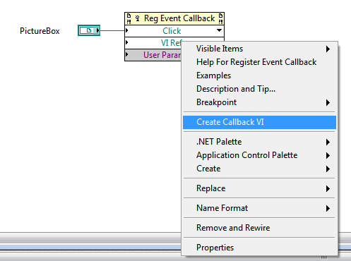

You didn't give any details, so I don't know how to answer your question, but this is what it looks like:
Wiring the control into the node lets you select the relevant event, and you can then generate the callback VI with a right click, which has the correct class as the e element.
If that doesn't help, look up more examples and tutorials about .NET callbacks. If that doesn't help, post actual code.

Actually, LabVIEW is helpful enough to create the callback VI for you if you right-click the node:
You pretty much don't want to do it any other way, because in addition to the format of the callback VI's terminals, it also needs to be set to be re-entrant, among other things.  Creating it automatically does all of that.
