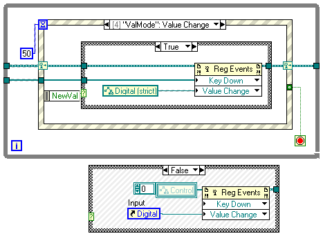

This posting is evolved from an earlier one, mostly because of altenbach's comments. I decided the VI should have been a state machine all along, and using this strategy more explicitly makes it much cleaner and uses dataflow better. I can't post my real problem because it's proprietary but the attached examples demo some of its required behavior. They still need a few local variables to get things out from inside several loops, but it's much less like a text-based programming approach. The end eventually got cute. I am sorry about that.
MultipleMethodsWithEditHang.vi shows the original approach, and it malfunctions because event handlers intended to work in different machine states step on each other. As Dennis Knutson and TonP point out, event structures are enabled whether the other structures surrounding them are or not.
MultipleMethodsWithRegisteredEvents.vi tries to fix this by using "Dynamic Event Registration", but still doesn't work. I think I'm doing something wrong, and after reading TonP's link, the "caveats and recommendations...", Help, and some of Travis & Kring, still don't see the light. Maybe there's some minor error or maybe the whole approach is completely wrong.
Questions:
1) Is this code still convoluted and stuck in text-based thinking?
2) The only reason MultipleMethodsWithEditHang.vi fails is because the event handlers are fighting each other, right?
3) How could "Dynamic Event Registration" fix this? Or, what did I do wrong in MultipleMethodsWithRegisteredEvents.vi?

1. Yes
2. No
3. See below...
It looks like you need code that when it starts allows you to change one value until such time as it it has decreased in value 5 times in a row. You then want to stop monitoring that input and start monitoring arrow key presses until a right arrow is detected. At that point, the "result" value is incremented 10 times and the code shuts down.
I guess I don't understand why you are using all the dynamic registation stuff or why you have multiple event structures.  Why not just use static events. To "turn off" inappropriate events, you can either disable the controls you don't want generating events, or modify what happens when the event fires based on the state the program is in (all in one event structure).
Why do you have a timeout event with nothing in it?
What is you program really trying to do?
Mike...

I fully agree with Mike! All you need is a single event structure. The biggest NoNo(!) is placing event structures inside case structures. An event structure needs to be able to handle events, and thus should never be bypassed by the dataflow.
All you need is a single loop containing a single event structure with several static events. You have about 80% too much code. 🙂
Please explain what the code should do and we can maybe make a quick draft on how to do things better and simpler.

For the love of everything, never ever put an event structure with 'Lock Front panel while event executes' in a case that hardly ever will be exectued
Heres the code to merge your two event case structure:

>For the love of everything, never ever put an event structure with 'Lock Front panel...
Oh. Hey, that fixes everything! Thanks! I guess I shouldn't need to be told.
Below is the example I should have written, without that error. It seems to do everything I wanted, the way I originally wanted to do it.
