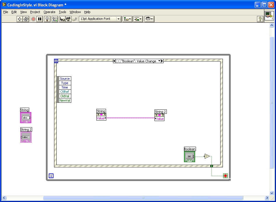

I am currently trying to get some really small program, which uses events working. I have prepared a small example:
http://666kb.com/i/afwqjnq2g2u6ntfum.jpg (I didn't include the image directly, I hope that is ok with you)

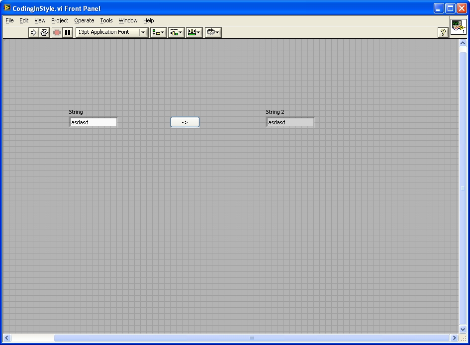

This program is supposed to write the value from string into string2 when the button is pressed - fairly simple 🙂
Until now, I've always used Property Nodes to reflect changes in the UI.
http://666kb.com/i/afwql50oo2a2r8sce.jpg
I was told, this is not really a good style, since it breaks the dataflow LabVIEW was designed for.
Now what I was trying to do was, to get the same functionality but while maintaining good coding style. How would I do that in LV?

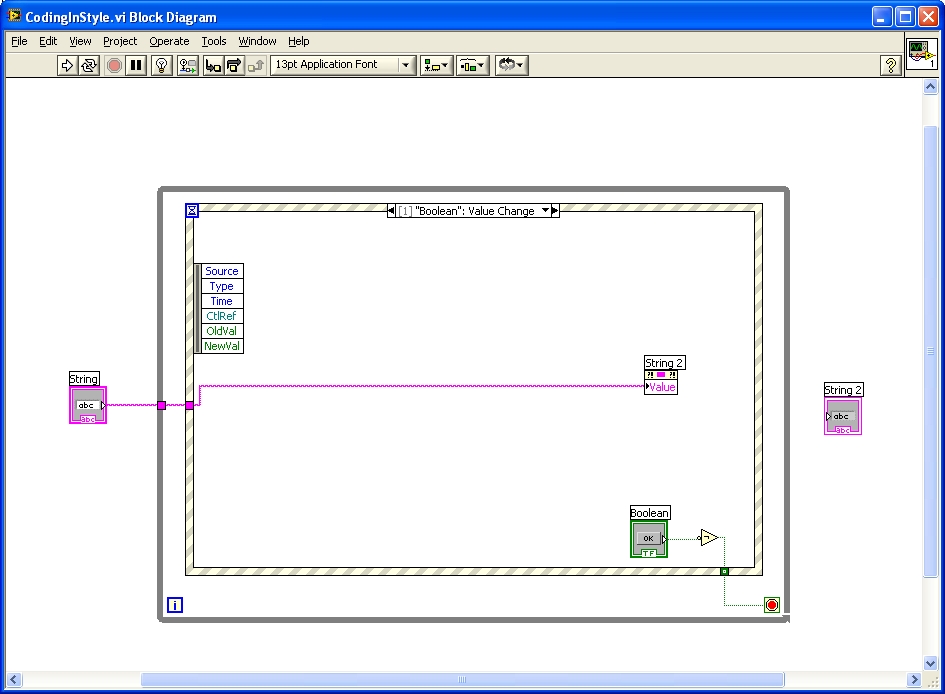

I was also trying:
http://666kb.com/i/afwqn3zntaa97d4se.jpg
Doesn't work, too.

Hi Thomas
Yes, you've been told right. Try to stick to the dataflow.
Now to your last two pictures. In both of them, you have the string control placed outside the loop. As you mentioned correctly, the value is read at the start of the vi. It doesn't matter if you wire it to a shift register or not. It is just read once when the program is started. To read it when the button is pressed, place it in the corresponding eventcase and wire it directly to the indicator.

You do not have to place it in the event, but in the loop that executes. In your example, you don't have specified timeout which is why I said to place the control in the event case. If the event occurs, it is read.
If you have several events that read the control, there are several solutions. Which range from multiple controls handled in the same event case to state machines using queues to exchange data.

I did not say the timeout is important. What I meant is this: if you placed the string control inside the loop, but outside the eventstructure and wire it into the eventcase, it would have been read and afterwards the eventstructure would have waited. If you then clicked the button, it would not have read the correct value.
