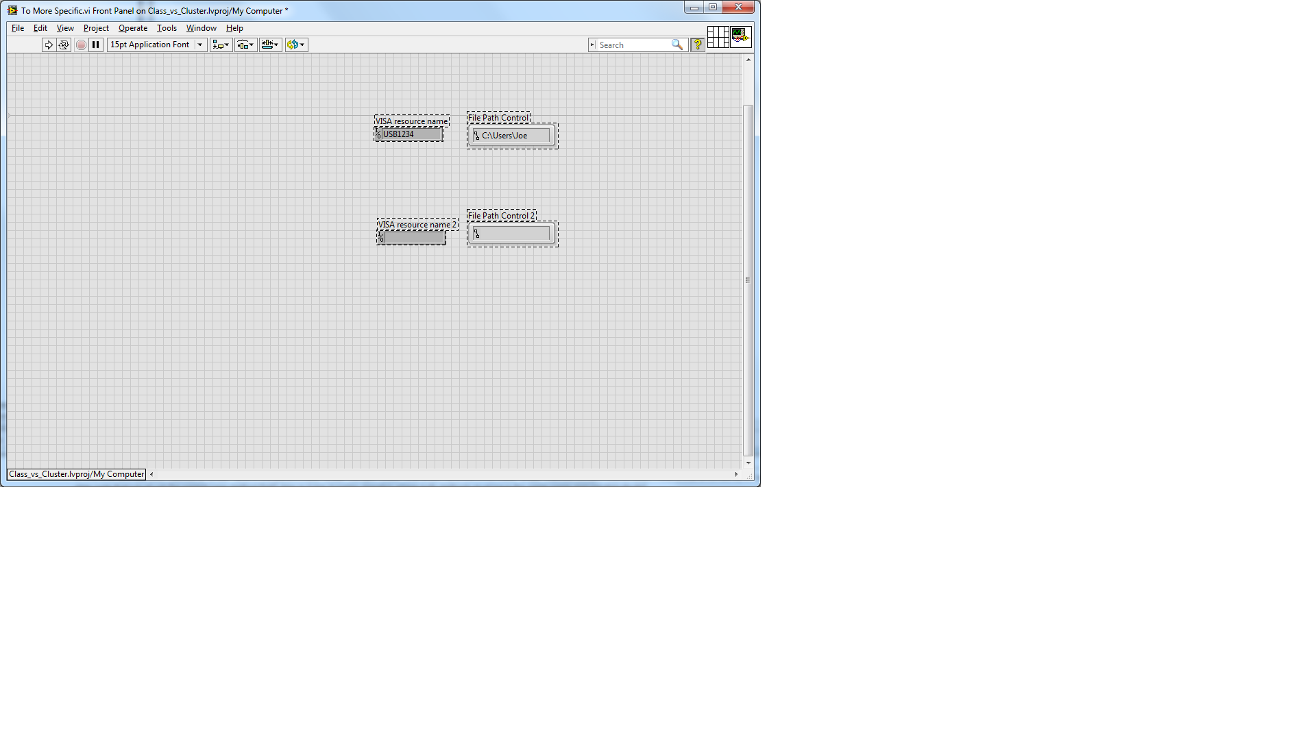

I have another question. Why is case 1 and 2 below produce different result? (i.e in case 2 I write nothing to the indicators)
Aren't class object suppose to act like a typedef. cluster? (i.e. Update the typedef. cluster/object and it's updated everywhere?). If not how to keep track of changes and use the same class object in different subvis where in some you set new value and in other you read them ?

So is there another way to do something similar?
No.  It's analagous to this:  You have a Tiger.   You use this Tiger as an Animal, then you want to use it as a Big Cat.  This works because a Tiger is an Animal and a Big Cat.   But if you try to use it as a Lion you get an error.  You aren't changing the class of the object, just the class of the wire.
They do indeed act like typedef clusters; but that is not how typedef clusters work.  These are not by-ref data structures.

FabriceToe wrote:
Nathand:
You cannot use To More Specific to force a class to be a different class
No. If you need the functionality of a child class, then you should use the child class in the first place, rather than an instance of the parent.
I'm not sure if you've misunderstood type defintions, or how they relate to classes. Let's look at this example:
Both instances of "Typedef 1" are linked to the same Type Definition, but it should be obvious that the Number indicator will contain 0, not 10, when you run it. Classes work exactly the same way. When you edit a type definition, or a class, that change (for example, changing a numeric representation) is reflected in all instances of that type definition or class. At runtime, each instance is separate; changing the value of one instance does not affect the others. Unlike in many languages, classes in LabVIEW are by-value, not by-reference, making them consistent with other LabVIEW data types. See http://www.ni.com/white-paper/3574/en/ for more details, particularly the section titled "How does OO fit with dataflow?"
Message 9 of 11

To add to the previous good comments:
A CLASS is a definition of a data structure with associated methods (visible in the Project).
An OBJECT is an actual created instance of that definition.
Please try to understand that definition.  Each wire is an OBJECT of type CLASS.  By changing one OBJECT you do not affect other OBJECTS of that type.
Imagine the horrors if by changing the value of a single Boolean in LabVIEW, ALL booleans would react accordingly.  Try programming with all that craziness going on.  OF course each Boolean is of the same TYPE but each instance is individual.
Your lower example creates two OBJECTS of type VISA and PATH (No wire connecting them).  Of course they do not have the same internal data.  They are the same TYPE (CLASS) but each copy is treated individually.  You CAN make them react as you think they should, but you need to program that on purpose.
