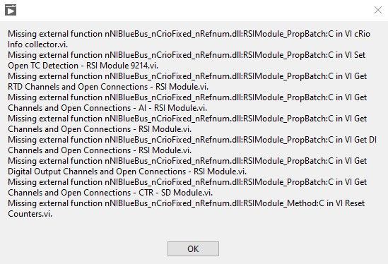

      This is my first time posting here so bear with me.  I have been using LabVIEW for over twenty years but rarely have created executables until five years ago.  Now to help deployment of test program I am in need of help solving a problem of running an installer program created though the build Specifications.  The executable works fine on the development PC however I get the following error when running on the target PC.
      I will need to Have the program installed on twenty PCs so it is very important that all necessary components are installed correctly.  We are using the PC as controller with an NI- 9149 Ethernet Expansion Chassis for I\O control.  Originally the test program was written in LabVIEW 2017 and Windows 11 has forced me to upgrade to 2025 for cRIO driver compatibility.  For compliance reasons I don't want to be loading LabVIEW 2025 to all the PCs I my companies Lab but need the program which seems to work fine on the development PC to work from an installer version on the target PCs.  Any help on this would be great since I have not found reference to this function any were.
      Other things to note the LabVIEW 2017 developed version does work on all target PCs though all had a copy of LabVIEW and most the correct cRIO drivers loaded by my IT department.  I have tried to load the cRIO driver on a target PC then install the program without success.  Also tried to add some folder structures to the installer build that did not work. I believe if I knew the folders and files that are needed, I would be successful.

After a few more hours of searching I found the actual missing file.  The file causing the problem was nNIBlueBus_nCrioFixed.dll.  For LabVIEW 2025 this file needs to be present in c:\windows\Syatem32 and c:\windows\SysWOW64 for RIO functions to be used in executable.  Once the file was added to the installer build specifications Destination View under the two folders mentioned the program worked as expected on the target PC.  Only question I have now is why LabVIEW was unable to determine it would need this file when it is part of the NI RIO driver, I think?

I'm not sure if you've found this link, but a similar issue has been noted in "NI CompactRIO Device Drivers May 2019 and R Series Multifunction RIO May 2019 (19.0) Known Issues" (linked here.) Looks like development environment settings and runtime settings/configurations aren't always synced. Please see the following text from the link:
Use of RSI Module Property Node in LabVIEW-built executable using CompactRIO 19.0 LabVIEW 2019 Runtime support will cause executable to fail.
CompactRIO 19.0 LabVIEW 2019 Runtime support is missing components which enable the use of the RSI module property node. When the RSI module property node is present in a built executable that uses CompactRIO 19.0 LabVIEW 2019 Runtime support, the executable will fail with an indication that a .dll file is missing, or with an error that says a refnum entry point cannot be found. The required components missing from the LabVIEW 2019 Runtime support are present in LabVIEW 2019 development support, so the RSI module property node will work in the development environment.

Thanks For the reply Messenger2.  yes, similar to 2019 as you posted.  Workaround I found for 2025 was to add the files to locations shown in picture. This is where I found the files loaded on the development PC.  It does work though not certain it is the best solution.
For the question of driver revision, this should have been the same as on the development PC since I had my IT group only run the installer build and no other NI installers.  It is possible the installer did not build as expected I just don't know.  At least the workaround is working.
