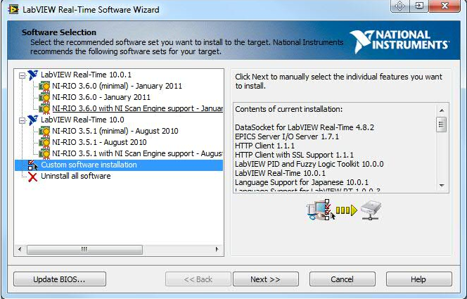

I am trying to run a simulink model on a cRio 9073 using SIT 2010. I succesfully created the FPGA vi and the lvbit file in order to map input/outputs to the model. I also created the DLL and OUT for the model.
When I run the interface VI on my computer, everything seems OK, until I get the following error and I am not able to run the simulation. I found a similar post earlier that suggests that I need to install the shared variable engine or the Simulation Interface Toolkit on my cRio. I tried to do both using MAX but could not find neither of the suggested installations.
Thanks for the help!
Items.viNI_SIT_driversupportVIs.lvlib:SIT Probe Model Items.vi loaded with errors on the target and was closed.
LabVIEW:  Failed to load shared library SITs.*:ProbeSignals:C. Ensure that the library is present on the RT target. Use MAX to install NI software or FTP to transfer custom libraries to the RT target.
Items.viNI_SIT_driversupportVIs.lvlib:SIT Probe Model Items.vi loaded with errors on the target and was closed.LabVIEW:  Failed to load shared library SITs.*:ProbeSignals:C. Ensure that the library is present on the RT target. Use MAX to install NI software or FTP to transfer custom libraries to the RT target.

Hola jarcTec;
Este tipo de error suena suele ocurrir cuando no se tienen las librerías apropiadas instaladas en el cRIO. Te recomendaría que abrieras MAX, debajo de la pestaña de Remote Systems selecciones tu dispositivo>> software, click derecho e instalar software. Aquí debes asegurarte que las librerías que te faltan estén instaladas en el cRIO. En Custom Installation selecciona SIT como opción para instalar en el cRIO tal y como se muestra en las imagenes.
Espero esta información te sea de utilidad
Exito en tu aplicación
Marisol
