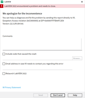

However, when I attempt to open "Dynamic Generation and Acquisition-Demo.vi", the following Exception: Access violation appears:
Error text: "Exception: Access violation (0xC0000005) at EIP=0x00007FFFB44FC3D9"
"Version: 22.3.1f8 (64-bit)"
How do I proceed? HSDIO 2022 Q4 is the only version of HSDIO I have tried so far where the example VIs even show up in Example Finder, but clearly I still can't use the examples due to this error.

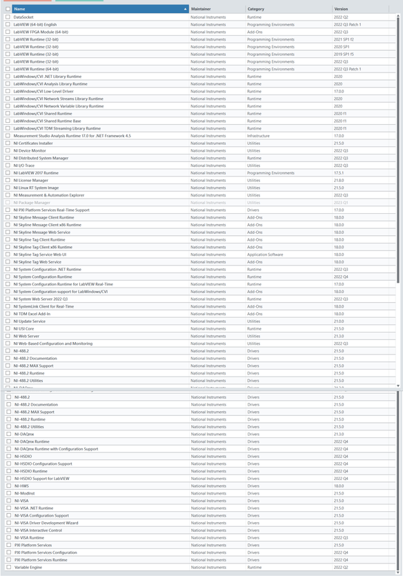

Update to Error: Here is the current list of packages I have installed:

UPDATE
These issues and errors still persist on 64-bit LabVIEW 2023, even after doing a repair of all HSDIO packages using LabVIEW Package Manager
As a quick test, I tried to run the same HSDIO Example VIs on 32-bit LabVIEW 2023 and suddenly the access violation error was gone and the HSDIO Resource drop downs worked and the VIs started working properly.
TL;DR: HSDIO works with 32-bit LabVIEW 2023, but not 64-bit LabVIEW 2023.
