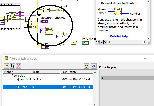

I would to convert my Response string (PM=2) command to Number. I use the Decimal String to Number. Later on that number is compared to get indication. I am not sure why I see 0 at downside.
Command: PM (power up mode)
Response: PM=2
I would like to get the number "2" from the response to compare it. But I get "0" when I look through the probe.
 Any suggestion?

Because it converts a string number to a number. You are sending it PM= which are not numbers. You need to strip off the PM= and send the rest to the decimal string to number function. It is not smart enough to figure out what you want to use in the string.
Only send the 2.

Since you wire an offset, things should work just fine. Are you sure 4 is correct? Can you show us the actual received string (not with a probe, but with an indicator set to e.g. hex or \-codes display)

You need to send an offset of 3 not 4

As a general note, if you don't know in advance where in your string the number is going to start, you can use the "Match pattern" node like this:
That will look for the first digit it finds, then keep going until it finds a non-numeric character.  So if you later want to use this on a different string, or make it a generic reusable subVI, you can use that technique instead of just a fixed string offset.
